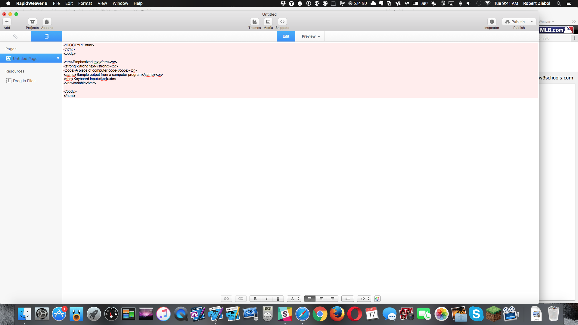

Not experienced with adsense but depending how you dropped it in, try selecting the code, go to Format > Ignore Formatting (should go pink). Otherwise it may be being read as text not code

How are you adding the code? Into a styled text page? Into a stacks page? Have you highlighted the HTML and gone to Format and down to Ignore Formatting??
I added it to the top of a Stylized Text Page. I tried the ignore formatting and still nothing.
