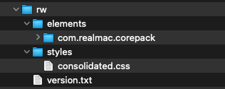

However not all the files in the rw folder in the subdomain are being published?
This is the structure of the rw folder at the main website root level:
This is the structure of the rw folder at the main subdomain level:
The folders com.logrunner.blog and com.realmac.apipack are missing?

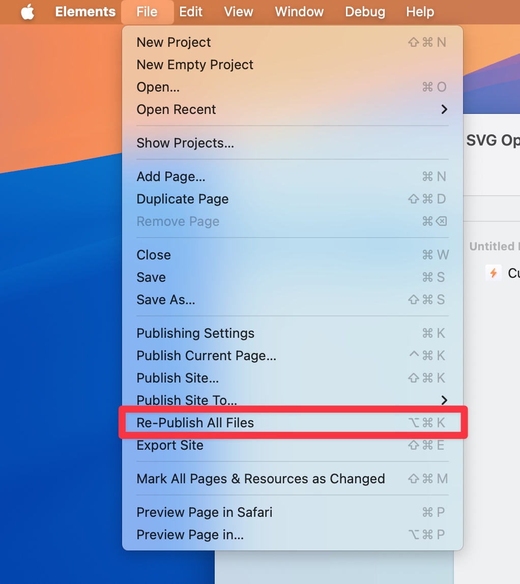

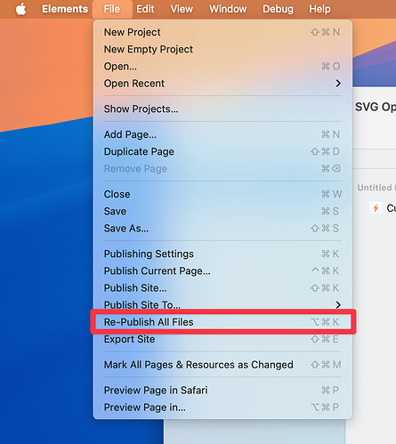

Sorry you’re having issues… have you tried re-starting Elements and choose "Re-Publish All files again?

This is the folder that was previously backed up:
The above should be created from the shared assets in a utilised DevPack:
