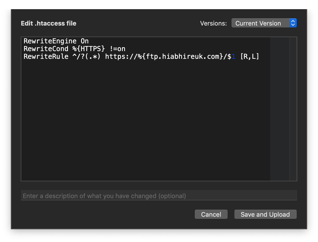

I have clicked on the edit .htaccess File and inserted the following code…
which broke the site

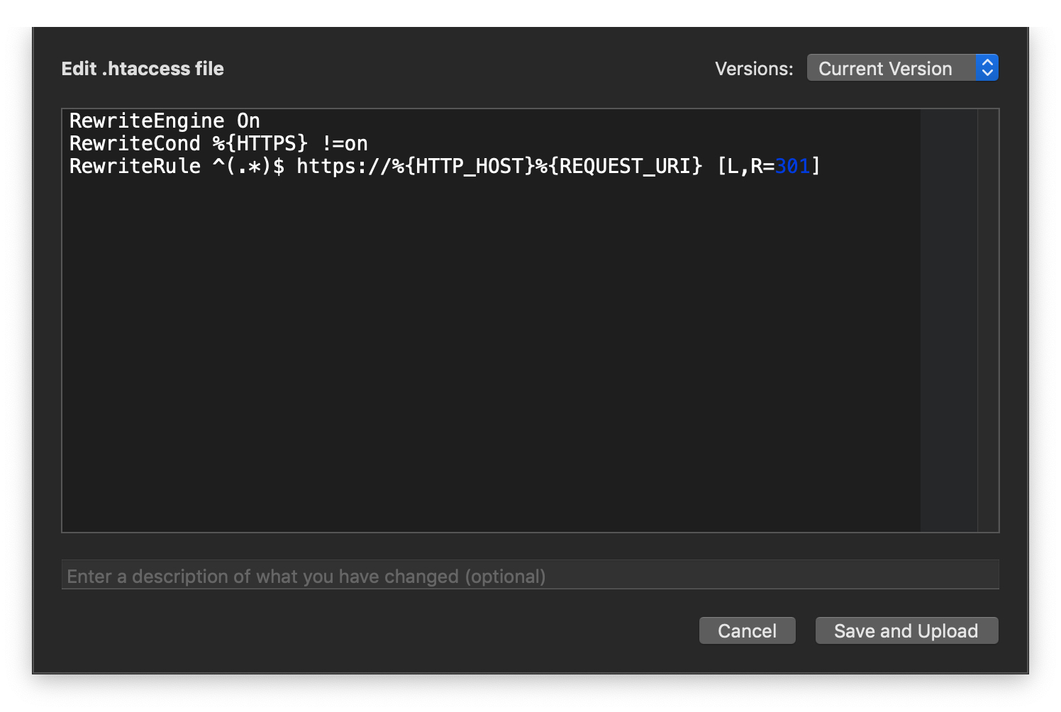

I then tried…
which also didn’t work.
I found this bit of code on the 123-Reg site here…
&Order deny,allow
Deny from all
Allow from env=SSL
but that also seems to break it.
So I have removed the code altogether so the site can at least be seen on http and https.
Can anyone help advise on how I can fix this, I have contacted their support line and they told me I have to figure out how to configure RapidWeaver to do this on my own.

Here is a rule that doesn’t even require you to add the URL (should work on anysite):
RewriteEngine On
RewriteCond %{HTTPS} !=on
RewriteRule ^(.*)$ https://%{HTTP_HOST}%{REQUEST_URI} [L,R=301]
