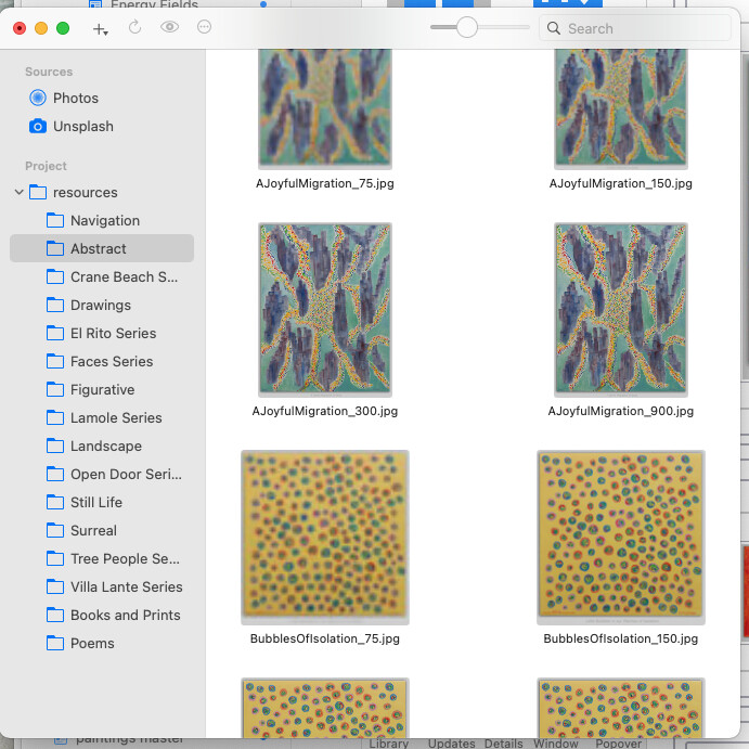

I’m a Dreamweaver convert to Rapidweaver and have read what I can find and watched quite a few of the videos on RW and Stacks. My site is all about images which I resized for my DW site and stored in subfolders beneath my “images” folder. My site has over 200 hundred paintings and each is resized for the web four different variations. When I added them to resources I put them in folders by my former categories. But when I use the “site image” stack the images do not show up in preview nor in view with a browser. In a former post I see that someone solved this problem by moving them all out of the subfolders.
Is there another way?
And a big thank you to Joe Workman for his excellent videos. Answered so many of my file structure questions.

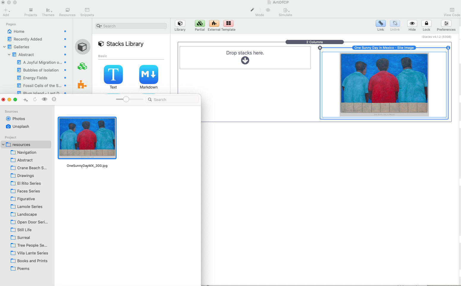

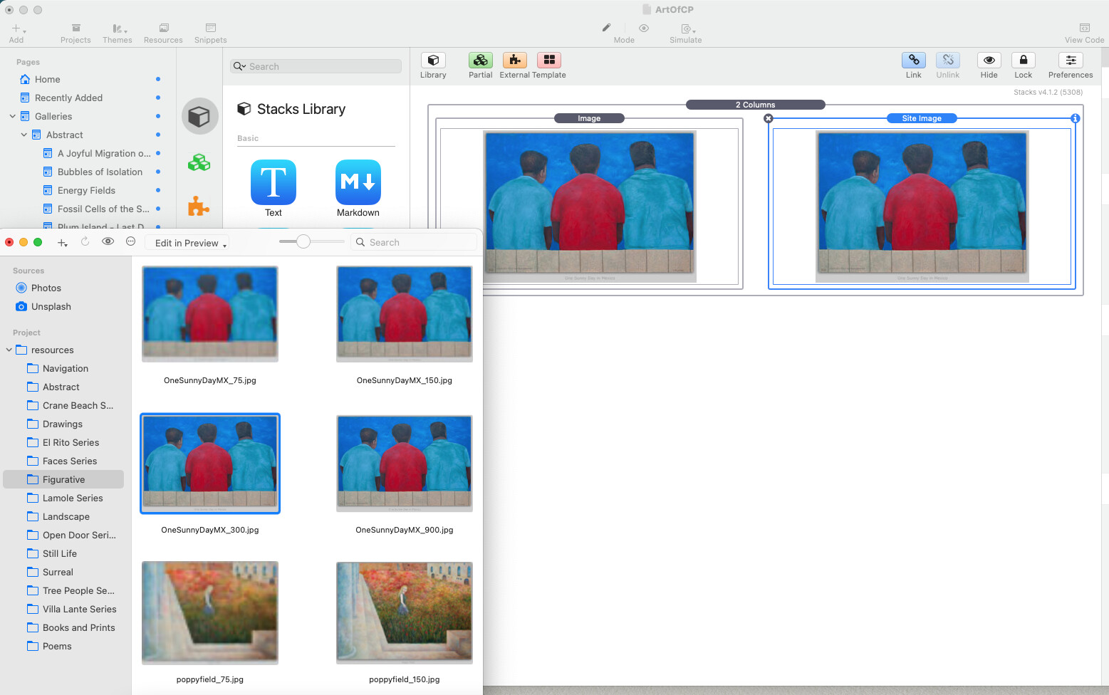

My RapidWeaver site is not online as yet. I’m building it offline right now. My current site is cathleenpalumbo.com but it is my Dreamweaver site. Here is a screen shot of the resources I am referring to if that helps.

Thank you Mark and Doug. I had watched the videos Isaiah did on Stacks 4 before I began, so I couldn’t understand why it wasn’t working. My only dilemma is how the use of the embedded image stack would impede the loading time of the page. The images are small enough in size and the 300 px size is the only one I will use on more than one page. I could move all the images out of subfolders but it is my preference to have them organized.

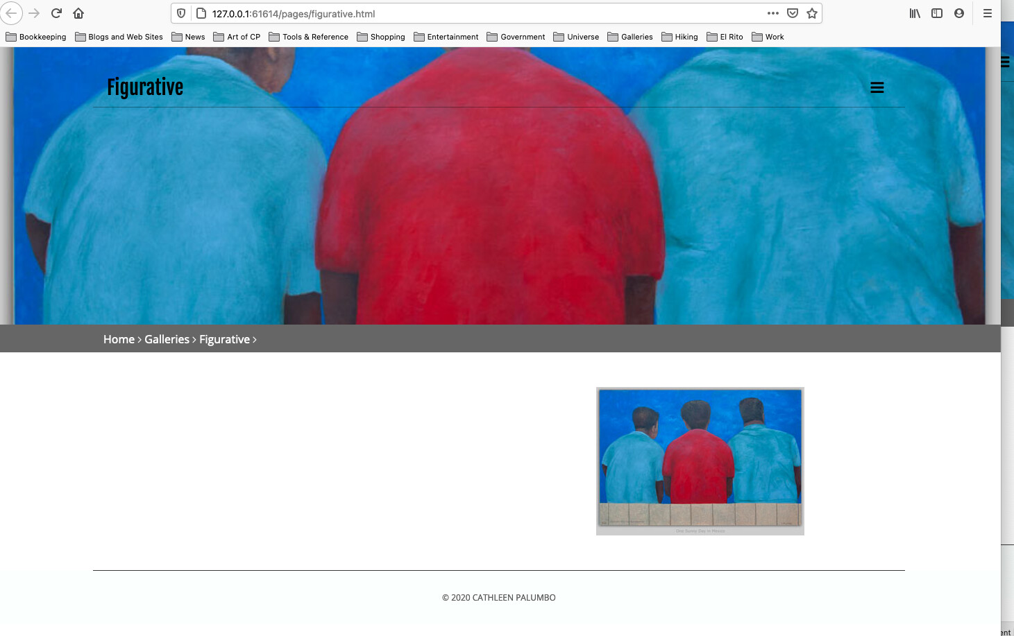

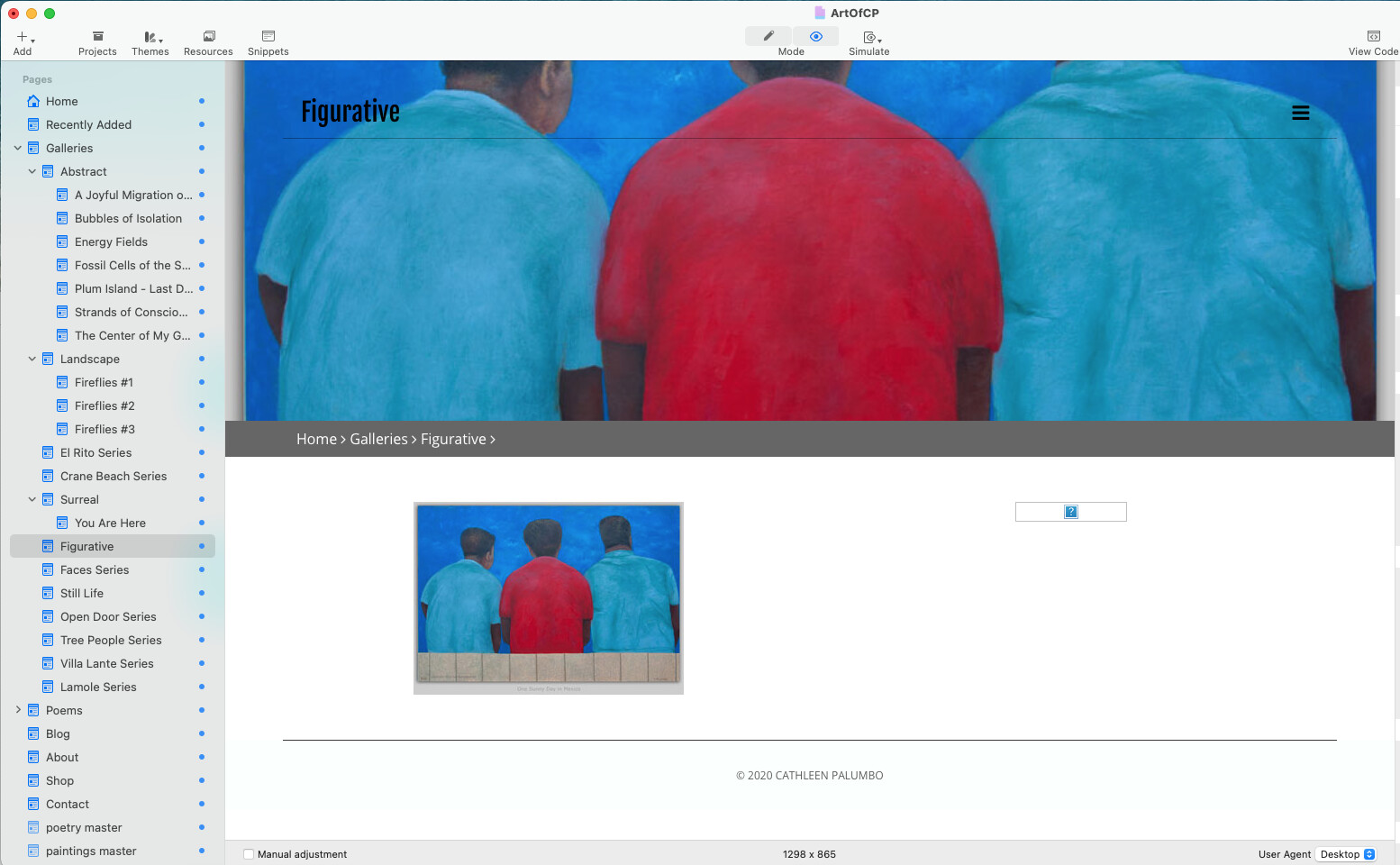

I did a little experiment to show what is happening. The screen shots below show a page with a 2 column stack. On the left is an image stack, on the right is a site image stack. The first view is edit mode, the second is preview mode, and the third is browser mode. The same image is used for each.

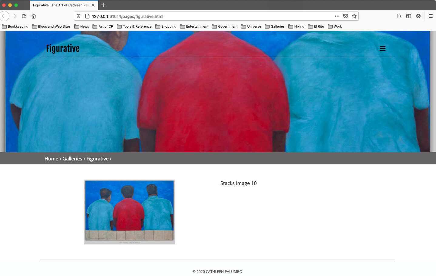

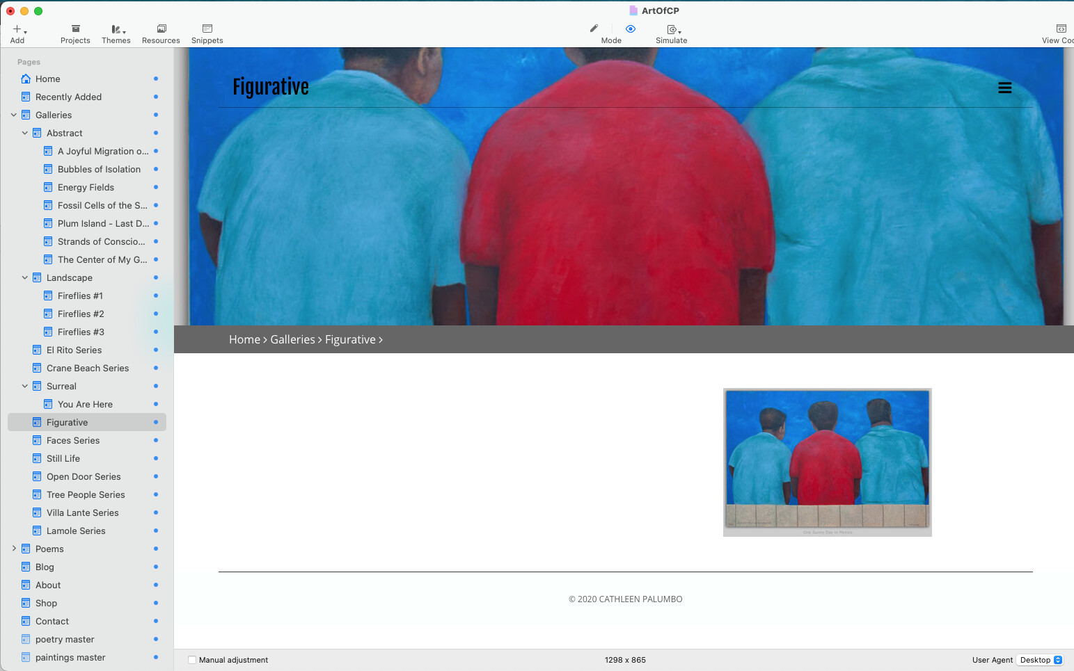

Then I moved the photo out of the subfolder and did the page again (using only a single site image for distinction purposes). The same three views are below:
