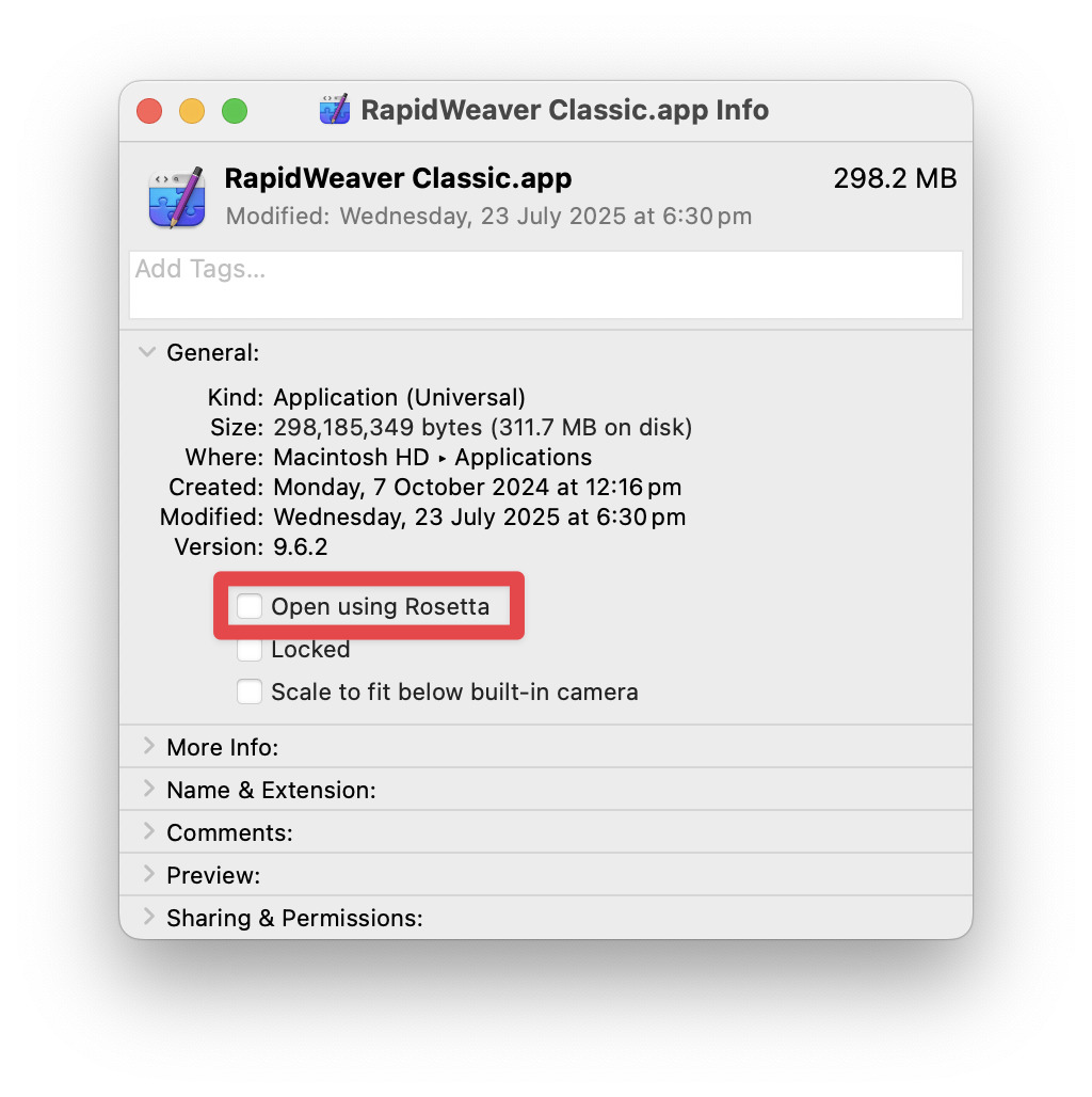

Get info on RapidWeaver Classic in the Finder and check the “Open using Rosetta” option. This should allow you to then run legacy plugins.
It’s worth noting that Apple have stated that they are phasing out Rosetta.
No that did’t work Dan - but thank you for your suggestion.
