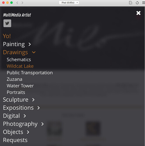

Thanx…the problem is I don’t know where to find the code. Oops. That’s the problem being a good designer and a lousy programmer. I did some “funny” stuff with the menu where I inserted sub-topics under a main one, etc. Take a look at my screen capture of the previews. It worked so I went ahead:
