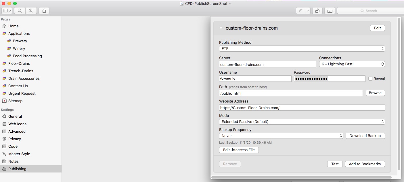

Here is the screen show of the large site:
Publishing-CD

Here are those settings:

I don’t use chilidog and I can’t find any public knowledge base. Not sure what the path should be for the second site.
The one that works uses public_html, the one that doesn’t uses a different path.
I’m assuming that the test button works on the site that’s not working.
You might want to contact chilidog support and wait for a reply, unless someone else can who is familiar with their setup can help.
