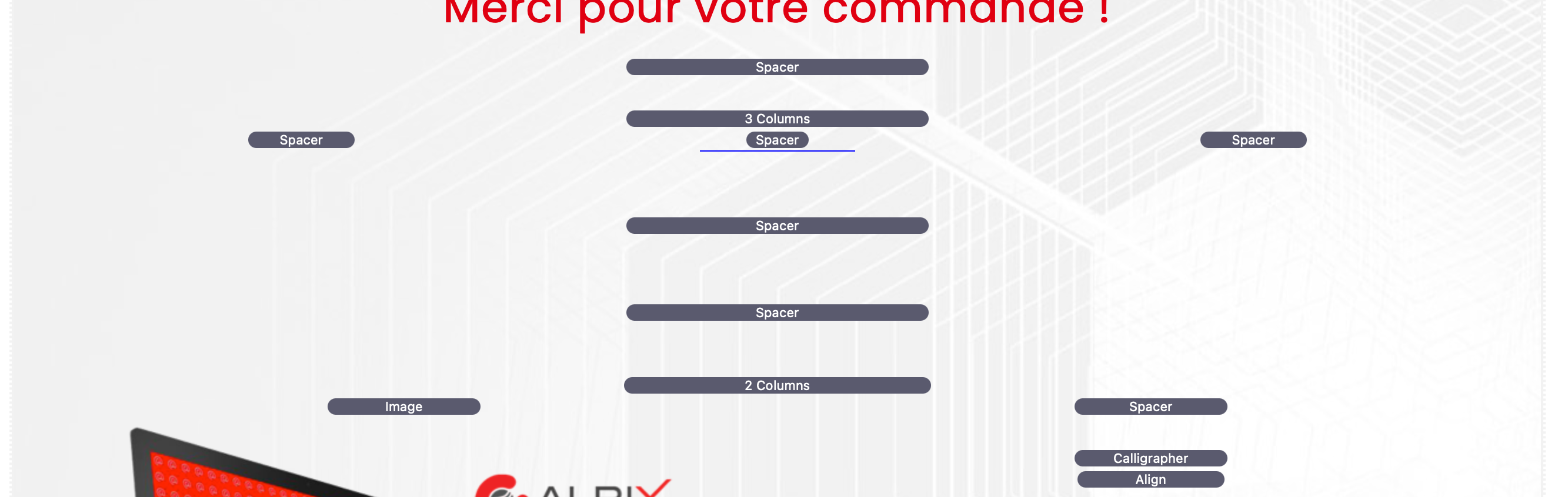

I’m having a problem with Rapidweaver 8 (or 9, it’s the same thing) with the grey edges of the stack frames not being visible. I have to click on them or enlarge the window to make them appear, and only partially.

Maybe with this link : Capture.png (2666×846) (alrix.ch)
Hmm this is a first. just looked at your screen shot. I wonder if you create a new project add on stack to it and see if the problem goes away. best I can think of if thats the case is one of your stacks is causing the issue or if its the stacks plugin that is the issue.

Hi Dan, after various tests, it seems that it’s actually the Aspen Stack Split that’s causing the problem. So I’m going to check with the publisher to see if there are any updates or changes to be made.
