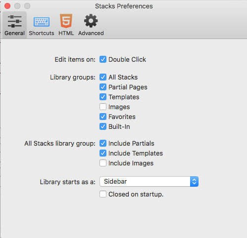

I noticed that when I open this test-project and fonts are not rendered properly, the saved viewing state (Inspector and Library) are not remembered as well, even though Stacks Preferences are set properly. After I open the Library panel (I always save with the Library opened), the text in Preview mode changes its rendering to chosen fonts. So, there is some kind of RW/Stacks cache involved and it doesn’t work properly.
Stacks%20Preferences
The state of the app, positions of windows, etc are stored in the preferences (a.k.a. User Defaults). The content of the project (like font settings) are stored in the project file.
So these issues are likely unrelated – but it’s perhaps good to keep in mind that multiple things seem to be behaving strangely.
