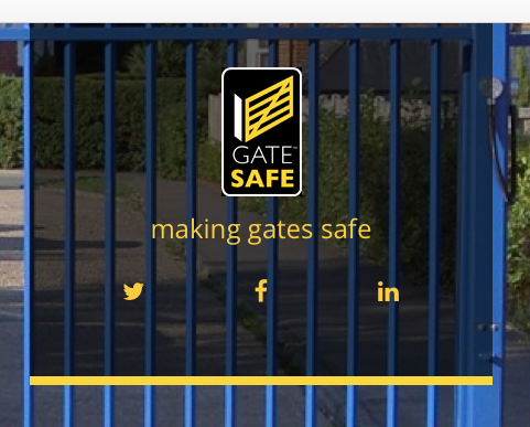

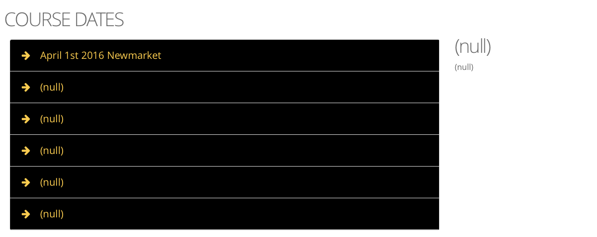

I’m having some problems with stacks in partials randomly disappearing or appearing to ‘corrupt’.
Using Elixir’s Abstract theme, Stacks 3, RW 6.3.8, El Capitan 10.11.4 (although problem was evident under 10.11.3 as well). Fairly large site - 50MB c. 50 pages
Examples shown in screen grabs - common thread seems to be that:
it only happens to content in partials
it’s random
clicking edit and then preview again seems to sort the issue on any given page
I have only seen this in preview and not in live site
Despite the 4th point, as a busy live site, I’m nervous of publishing in case the glitches happen live.
Any assistance much appreciated. Never had this problem before and not experienced on any other sites.
