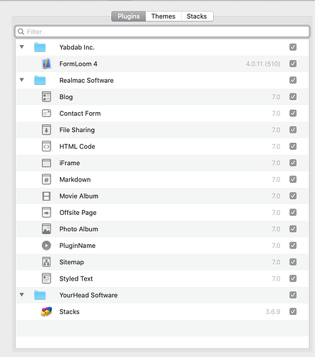

Before the upgrade I copied RW Addons to a folder and imported them in RW8 however, I also see that there is a folder in the same folder with Plugins Disabled?
How do I know if all plugins are up to date?
On the bottom left side of where your stacks are listed you’ll see an area to check them and update them.
I have done that and there are 3 updates, after that no success.
Generating checksums keeps coming.
The update button on the lower left side only checks for updates for stacks not plugins and see what plugins you have. You can see the versions and then check manually with the vendor to see if there is an update.
My other suggestion would be to launch RW6 and see if the or prior to converted project file (the old one should still be there unless you deleted it) does the same thing.
RapidWeaver should check for plugins updates upon launch.
I’d probably have a look at the addons manager in the menu bar and under plugins.

That could be true because I have all addons and plugins moved to a folder to be able to load in RW8, but unfortunately this still doesn’t work.
I followed the instruction Manually copying about addons from RapidWeaver 6 or 7 to RapidWeaver 8
At the bottom appears when you launch RapidWeaver 8 now, all your addons should be installed and available. But unfortunately !!!

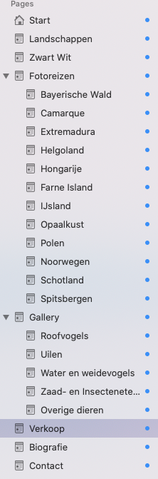

in RW6 I also saw the dots behind the pages delete during export, but that is not the case now either. The export stays with the ‘sales’ page

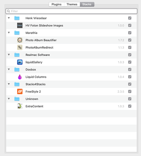

possibly the problem is in HV Foton slidshow images stack, See screenshot what happens if I want to use the stack in a few pages.
I also don’t know if the stack HV photon slidshow images is suitable for RW8?

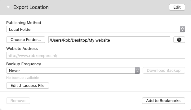

I have created a new folder with MY website and exported to it, unfortunately it stops and starts generating generation checksums.
then I changed all pages as unchanged and 1 page as changed then public page but unfortunately also then checksums and happens with every page

As for the HV photon stack, I don’t know if it is the problem, Henk Vrieselaar themes we’re taken over by @willwood. You can check out the this link, there is a Henk slider stack: ThemeFlood | Stacks
I’m not sure if I understand what you have done here.
Did you set this up in the publishing settings or did you export from the file menu?
What I suggest You try after you Get the serial number fixed, and check for updates for the theme and stacks.
- go into publishing
- Choose local folder from the publishing mode dropdown
- Choose the new folder
- Right-click on a single page on the left side
- Select publish page
You shouldn’t have to mark or unmarked pages as changed.

I did set up in the publishing setting.

Am still trying to get RW8 working. HV Foton slideshow image Has Will never heard of?
Strange because I have contact with Henk Vrieselaar and he says that he really should know this stack, well rara
It also appears that HV Foton does not merge with LiquidGallery, so I have to come up with something else.
