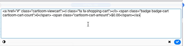

<a href="#" class="cartloom-viewcart"><i class="fa fa-shopping-cart"></i> <span class="badge badge-cart cartloom-cart-count">0</span> <span class="cartloom-cart-amount">$0.00</span></a>

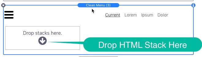

Take that code and copy it into an HTML stack.
2020-05-31_12-12-54
On the Clean Menu stack drag and drop the HTML stack into the drop area:

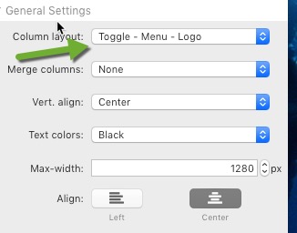

On the clean menu stack I’d adjust the Column layout so the “Logo” (that’s the drop area) is on the right side. Shopping carts are traditionally on the upper right side.

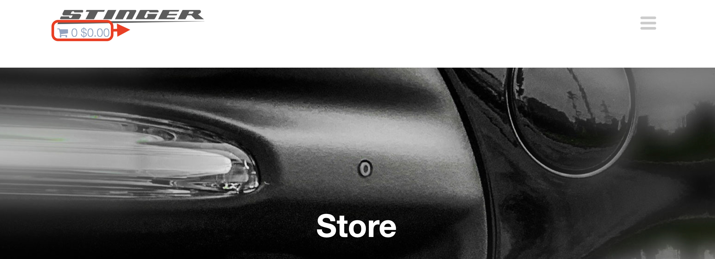

And this is what it should look like:
Thank you Doug. You rule. I get the principle now and am playing around with the options.
Do you think there is a way to keep the logo in the menu bar? It looks odd without it. The only way I was able to do it was by putting the cart right under the logo but that looks off as the cart does not center under the logo…
If I put the cart to the right of the logo the logo becomes incredibly tiny.
