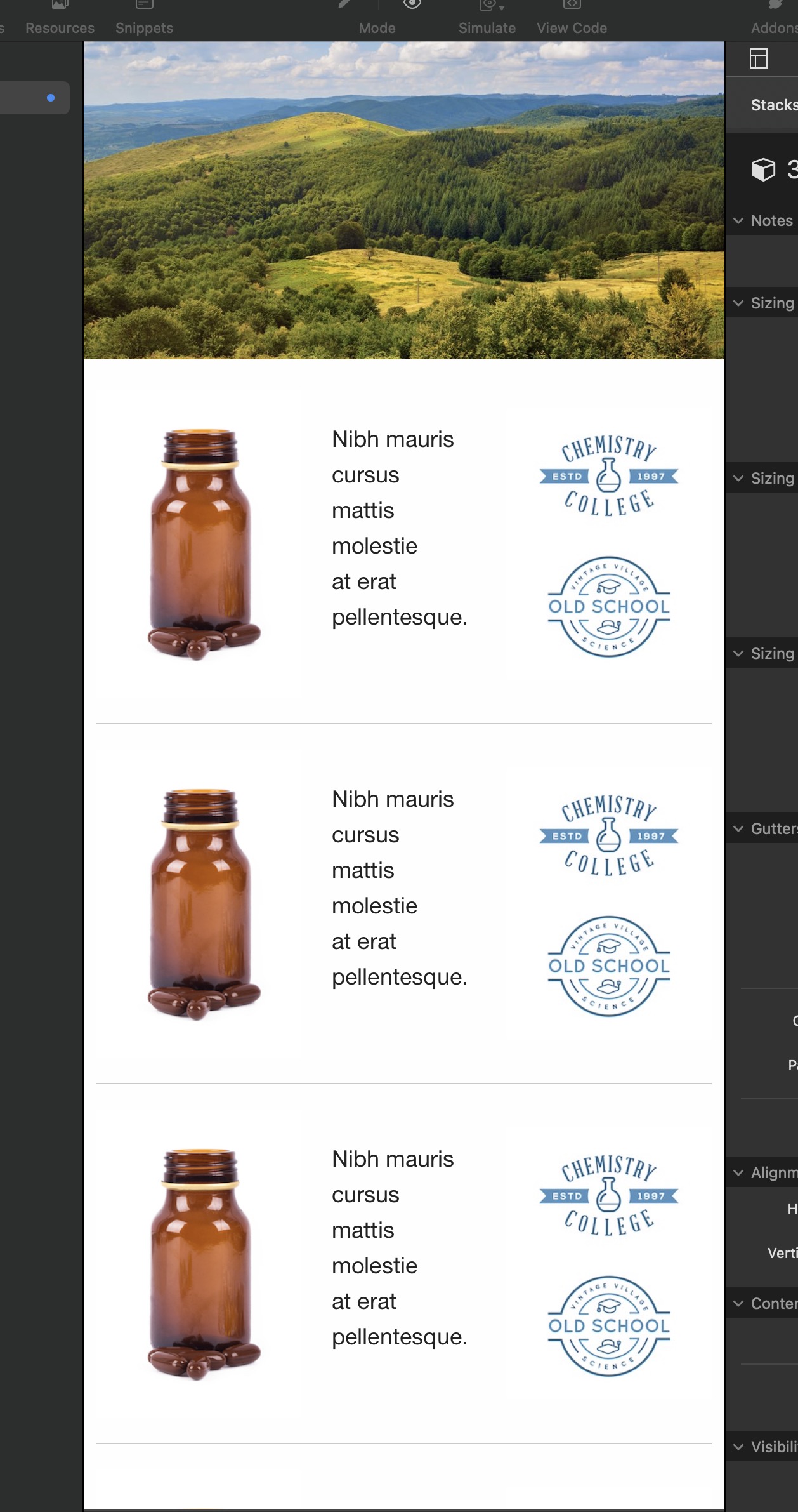

I trying to build this simple layout page on RapidWeaver but it seems Foundation 1 is not letting me to build a column as the sample, so Its always like responsive. check the sample and my result and see what I’m talking about. is this possible with a special stack? or theme? it’s literally one stack on top pf the other and Foundation is not letting me do it!
here is my attempt: https://bit.ly/3y92fX5
I’m not sure from your screenshot exactly what you want to do. Are you trying to stop the different sections spit by the dividers from stacking on top of each other?

Pretty close, but it looks like you’re using columns. Not sure with Foundation, but with Foundry, you can disable “stacking” of columns on mobile.
Is this the sort of thing you are looking for, full screen and mobile screenshots here as a demo. The items stay on one line when the screen shrinks on mobile.
If you want 2 columns for all screens then just set each column to 6 units wide (There are 12 units total width) and turn off the Tablet and Desktop sizing checkboxes.
If you see in my sample (i really didn’t work on mobile yet) I tried to do the same but it seems the goal is exactly the same and that means the fixed width too. I don’t know how to achieve that.

You could use a normal Stacks `1 column to wrap the entire page. Set the 1 Column to be a fixed width. Then you can keep your Foundation stacks as they are.
