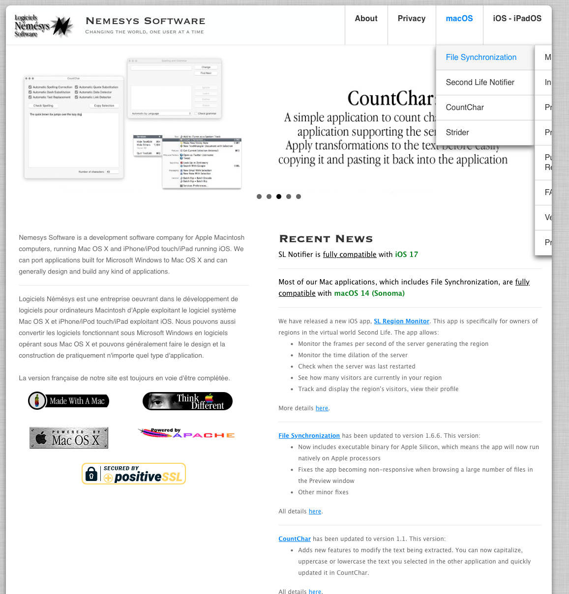

After resolving my issue with the lastupdated tag, I republished all the files on my local disk. When I open the “index.html” generated file, I’m getting this:
However, when I preview the same page from RapidWeaver into Safari, it looks fine:
Minor issue: is it possible to have the menu to extend past the edge of the page?

I’m kinda confused on what the issue is. Are you using MAMP or something similar to try and preview your site locally on your Mac before uploading? If not you might experience issues trying to preview the locally published site (like you appear to be having).
If the site looks ok when you preview it in your browser using RapidWeaver’s built-in “preview in browser” feature, then it’s fine to upload to your web server.
If you are really concerned, why not create a subdomain at your web hosting provider, something like staging.example.com. Then you could duplicate your RW project file, open the duplicate project file in RW, change the URL to staging.example.com in the General settings, and upload the duplicate site to that subdomain. From there you could check for any mistakes before you published to your main domain, and you’d have the added benefit of actually previewing what the site looks like on your live server, so you’d have more accurate results.

Not sure what MAMP is but I don’t think I use it. Yes, I generate it locally to check for errors. The thing is, after switching themes, it will generate correctly on my local hard disk. But there are some error I need to fix and when I modify the theme style, then all hell breaks loose for no reason. For example, one problem I’m having, and I don’t know it it’s because the site is local, I have a main menu at the top with an item to open a privacy page. For some reason, from the locally generated site, when I click on that item, the page opens a folder in the Finder. Very weird.

It’s customary for the final one or two ‘parent’ page links in a right-aligned website navigation menu to be standalone links. That is to mean, without any child / subpages to display.
Commonly the final one or two page links would be reserved for singular pages, like an FAQ, terms, or contact / support page. This helps cushion the menu from the extreme right side of the screen, providing space for drop-downs to show.
It would be possible to use custom CSS code and dictate that drop-down menus should open leftwards, instead of in the default rightwards direction. However I’m personally not overly keen on the idea, from a usability perspective. It is second-nature for most people to expect a drop-down menu to open downwards, and then track rightwards if there are additional levels of links to show. To reverse this, might add a degree of awkwardness.
In the same way, if you right click on the far right of your desktop. The little carets in the menu point rightwards, but the menu items open on the left side. Something that has often irked me.
I seem to recall you are using one of my theme designs. I’ve tended to add settings so that you can change the alignment of the menu to something other than right alignment. You may want to explore the theme style settings and perhaps experiment with a slightly different navigation bar alignment, if such settings exist in your theme. Alternatively we can explore using some custom CSS code to get things working more to your liking.
Every website is unique, taking into account of the quantity of page links to be shown, their length, and the addition of subpages. What you are seeing is an age-old problem that has persisted for the 20 years I have been doing this. Although we can attempt to find a “sweet spot” and design a menu in such a way as to avoid this, I think there always will be some edge-cases that come along and require some extra thought.

Will: what CSS should I input to make the pages in Sno3 wider? I don’t have the option in the master style to set the width.

Going by the website link https://www.nemesys-soft.com/ in your screenshot.
@media (min-width: 576px) {
    .container {
        max-width: 540px;
@media (min-width: 768px) {
    .container {
        max-width: 720px;
@media (min-width: 992px) {
    .container {
        max-width: 960px;
@media (min-width: 1200px) {
    .container {
        max-width: 1140px;
That was the code the original theme developer used for setting the maximum width for each screen breakpoint.
So below 576px the container is always 100% of the screen width. Above 1200px wide, the container is capped at 1140px wide.
You probably don’t want to go much wider than 1140px wide, unless you intend to split your content up into multiple blocks or columns. Long lines of text are difficult for people to read and a mistake I see some RW users making.
