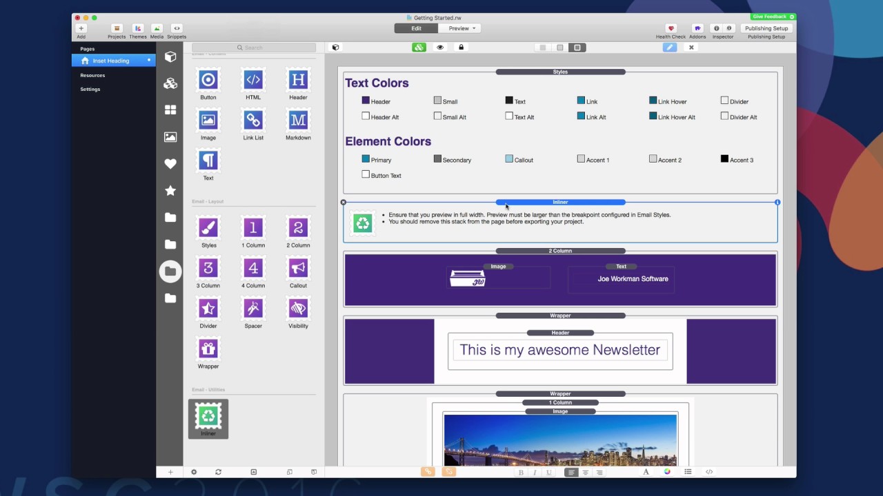

Having taken a look at the JW tutorials I am stuck on the export process which Joe’s videos show as a simple cut and paste operation from an ‘Inlined email’ panel within RW. This inlined HTML is then pasted to make the Sendy template. This is where I am getting stuck.
My panels are different - I have ‘Email HTML’ & ‘Email CSS’ along with ‘Text Email’. I do not see ‘Inlined email’ as shown in Joe’s tutorial.
How can I get the ‘Inlined email’ panel to show please?

Thanks. Yes I’m using the inliner stack. When I preview it looks like this.
Your screenshots match what I see in Joe’s tutorial ( ie the ‘Inlined Email’ panel shows ). You can see how mine differ. This is the nub of my issue. Everything else is fine.
I think that is a very old version of the inliner. Have you ran the updater?
Thanks. I’m hoping it’s a simple fix. If you can see my screenshot in the adjoining post you can see the exact problem. I will drop a line to Joe too.
