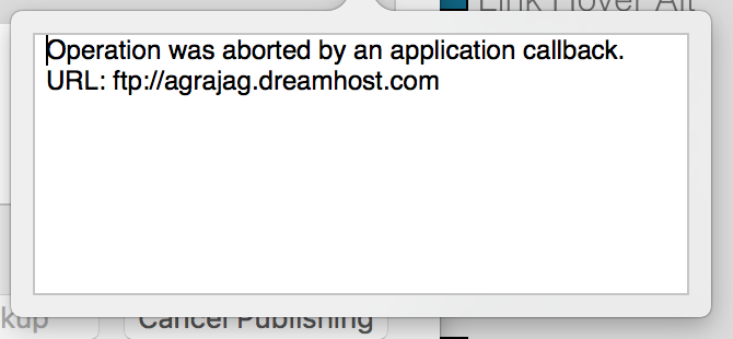

I’m having the same problem with 7.4 and 7.4.1beta. My hosting provider is Dreamhost, and I’m on their “Happy Hosting” plan, i.e. shared hosting.
It appears that some files are uploaded before this failure happens. Once it happens, I cannot close the publishing window and have to force quit Rapidweaver.
Also, I can browse using the browse button in publishing settings. I spent some time w/ Dreamhost support, and they found nothing wrong. I was subsequently able to upload all files using a dedicated ftp client, (Yummy FTP.)

Ok so I’ve had the publishing problem for a week now and haven’t really got anywhere with Rapidweaver support. The problems are:
  1. Publishing fails after a few files have been published. The error is operation was aborted by an application call back. I did have to force quit, but RW support sent a link to a newer beta and I can now cancel when it gets the error without having to force quit.
