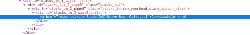

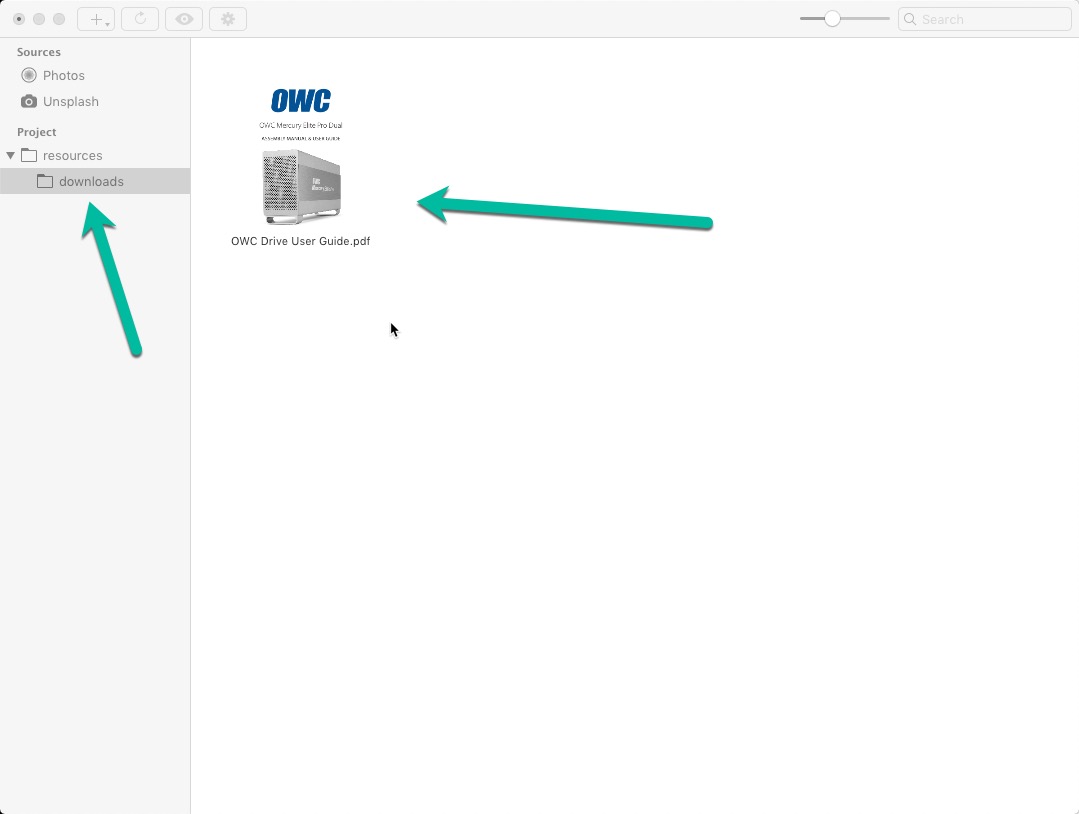

    1. I was trying to recreate the problem so I started with a brand new project.
    2. I added a single stacks page
    3. I added a folder to resources (named download)
    4. I dragged a PDF into the downloads folder
    5. I then used a standard stacks button and set up a link the resources (downloads .PDF)
      2019-07-20_13-54-39
everything works as expected.

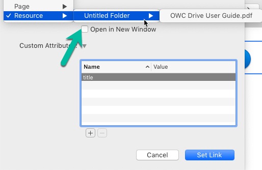

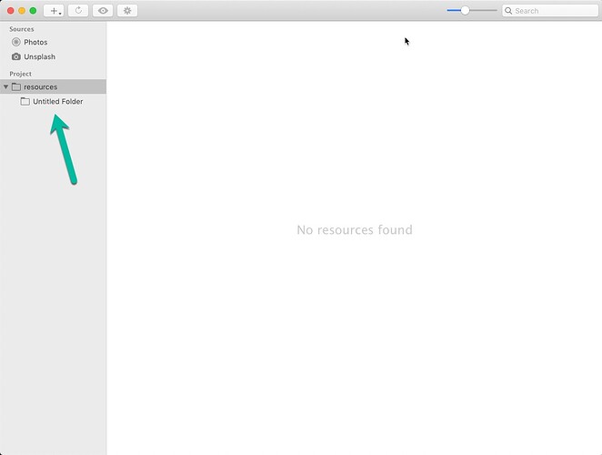

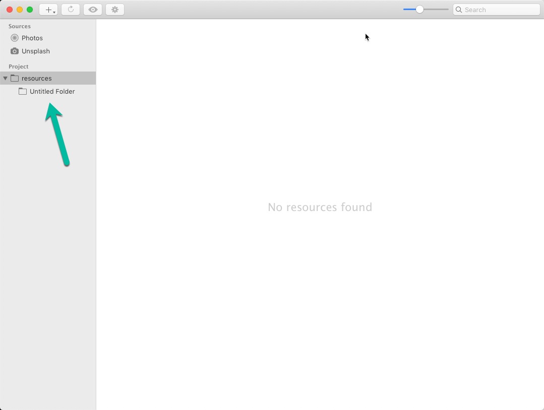

  1. I then saved the project shutdown Rapidweaver and fired up the new beta.
  2. The downloads folder is now renamed UnTitled Folder still
3. The links changed ok to now link to the new name.
2019-07-20_13-57-33
I was unable to get the resources-link to point to the folder like your screenshot shows

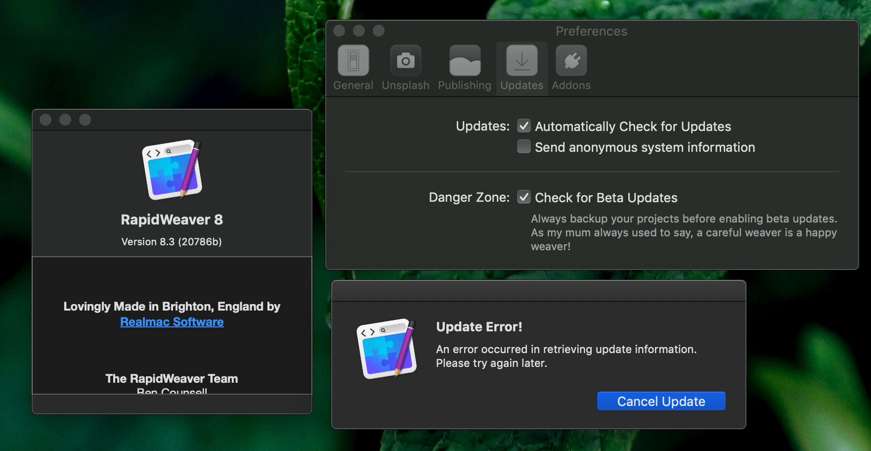

Check for Updates seems to be having trouble using 20786b.
Internet on this machine seems fine and Stacks own Check for Updates function works fine. Let me know if you need any input from me.

@teefers those steps are perfect - I’ve been able to reproduce this bug and will get it fixed up.
@jbob Glad you got your links working again, it’s quite possible that a previous build caused the problem. I’ve not been able to reproduce the problem you describe using the latest build.
