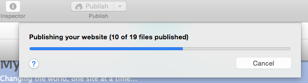

This is absolutely not a network issue. Publishing is extremely slow and, actually I have never seen a successful published site since I upgrade to 6.3.3 .
I have a small test project.
With PlusKit in the project, RW always publish 19 files, without any changes, always 19 files.
When I make a change in a page, RW publish only 2, 3 files.
After, without changes in any page, RW publish again 19 files! Strange!
When I delete the PlusKit page, RW publish 1 file, when I make a change in a page.
Without any changes, RW publish nothing, after exporting.
I think, RW works perfekt, but the PlusKit plugin brings a problem!

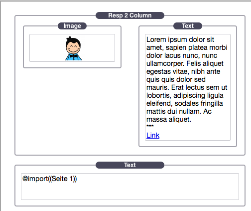

The problem with PlusKit appears only in combination with Stacks.
I am also having problems after upgrading to RW 6.3.3 and Stacks 3. The first edit to a couple of pages caused my entire site to be republished (1158 files) which took hours. Today I made a small change to a single page, and again RW wants to publish 1158 files once again. I do have a PlusKit page in my site files.
Correction!

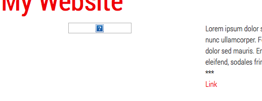

The problem exist only, when the @import(()) code is in a Styled Text page.
When the code is in a Stacks page, no problem!
Nothing to do with Stacks, I think.
The problem is PlusKit
PlusKit @import(()) breaks the Image Stack.
