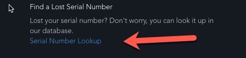

At the bottom of every Yourhead.com page, you will see a "Find a Lost Serial number link:
2019-10-28_12-48-46
Click that then click on the Cartloom Serial lookup (Post 2009 purchases)
2019-10-28_12-50-05
Enter your email address, you will be sent the serial number via email. If you have problems like old email address then follow the instructions.

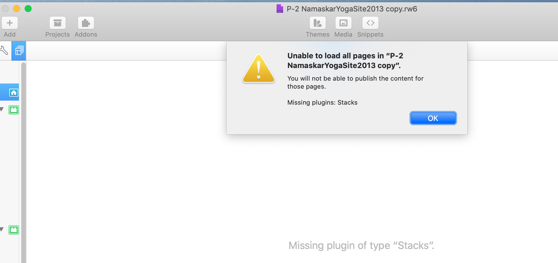

Ok, to my knowledge i have downloaded RW6 (thought it was 6.4 but might be 6.6) . Also found the license for Stacks and believe I downloaded that as well.
When i try to open my file the below two screens pop up (not sure you will get there screen shots. The below one says: Stacks RW can not be open because the developer can’t be verified. I hit cancel and the below screen (sent in the following email) pops up
The below screen shot pops up next and says: Unable to load all page in (my file) . Missing Plugins: Stacks
The result is exactly where I was when I reached out to you all… : (
Help…?

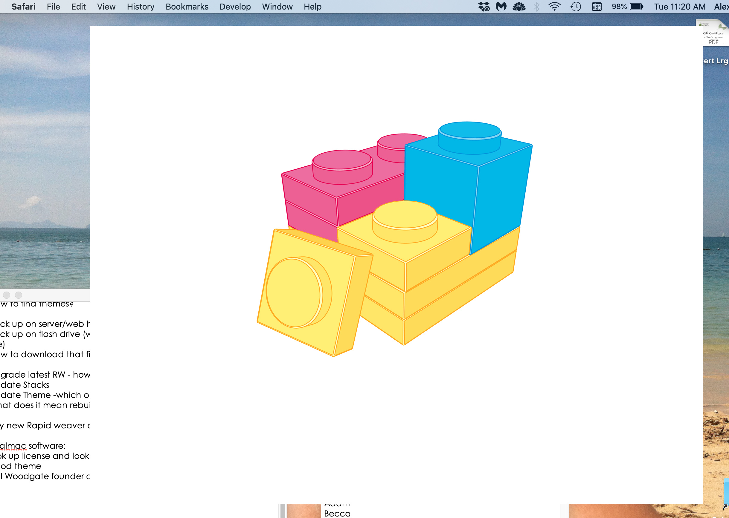

So I am trying to follow your directions and am getting stuck at the part where I try to open a new project. I do this, then add stacks, and then the application freezes with the spinning beachball and I have to force quit it. Happened a couple times. Then I got this big stacks image that I can’t get rid of (I will soon restart my computer and hope that does it).
