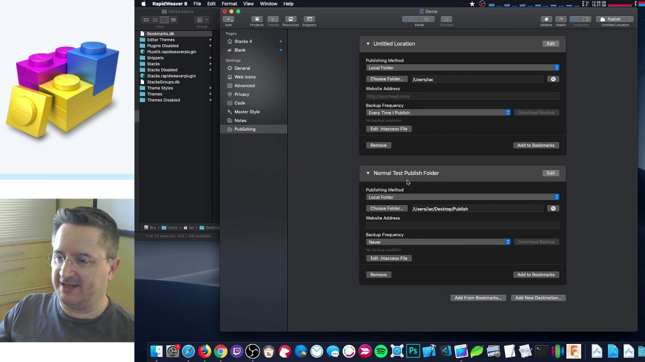

Here’s a post with some screenshots

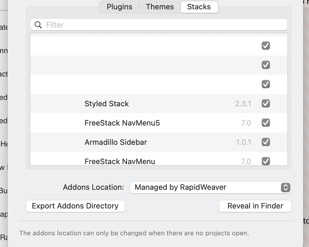

Now I have stacks in the library, but “not installed” Plus in Preferences I now have blanks
What’s the plugin window show?
As for the blank stacks @isaiah might be able to help.

Thanks for the response. I have Stacks 4.x installed, but when I came home and started computer again, Stacks isn’t installed.

With RW open, use cmd+7 to open the addons folder that its using.
As Joe said, that’s the one being used. You can also change the folder to where you want in the addons manager.
If you have an hour to kill @isaiah has a really great video on the addons folder
Well, I’m back to where I was a few days ago… I have followed all the suggestions and have learned a lot. Still not getting stacks 4 to install, but I’m closing in on the solution. I’ve created my own add-on folder location & working out of there.
My problem is that I am only a casual user of RW, so opening it to start a new site meant a lot of updates. A year ago, I installed a SSD & moved the RW files to an external drive. When I ran RW, I think thats where all the different folders came from. It didn’t want to run from external drive, so I moved RW to boot drive. Then I compounded it by my zealous instinct for tidiness. My files/ etc go back to 2009, so I had a lot of STUFF. I didn’t realize I could purge STUFF till I saw Isaiah’s video mentioned above.
