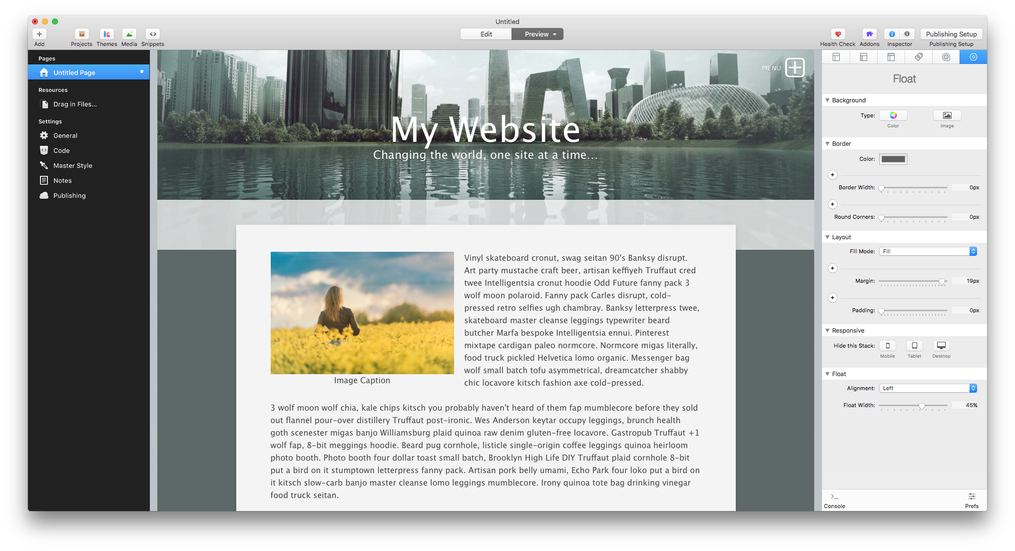

Why not just use a Float Stack and add a text stack below the image as a caption, like this:
Which will give you this:
Wow… thanks for the illustrated example… but my pic can appear anywhere in the article so it’s not always at top. And the float stack only allows pic at top… right?

Unfortunately, yes, it is only on the top. I really do not think there is a solution for what you want.

@zeebe… Thanks for the prod to think more about the obvious use of a “Float Stack.” I ended up doing just that (using a float stack) with an ImageCaption stack (stack4stacks).
In those cases where the image appears lower in the article I just use another text stack above and I split the text at the appropriate place. I receive all my text copy from others (Pages files) and believe it or not I’ve pasted so many articles into text stacks I forget that they can easily be split into different stacks! Can’t see the forest for the trees!
