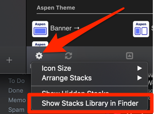

If you go into Stacks and choose “Show Stacks Library in Finder” from the gear menu there what pops up?
Pasted_Image_9_12_19__9_29_AM
No matter what is reported by RapidWeaver or by any other source, this folder that opens is where Stacks is looking for your stacks. There are two possible outcomes here – and about 90% of the time I hear this problem the first solution fixes it. And 90% of the rest get things fixed by the second. Occasionally there’s someone with real hard drive issues beyond that – but we can cross that bridge when we come to it.
  • If this folder is empty or contains fewer items than you expect, well, there’s the problem.
    Solution: move your stacks into this folder, Quit, then Re-launch RapidWeaver and you should be back in business.
  • If the folder opens and contains all of your stacks, then RapidWeaver and Stacks are looking in the right place but don’t have permission to see this directory.
    Solution: Un-set and then Re-set the Addons location. This will tell macOS that you’re giving RapidWeaver permission to see this folder. Here’s how to do it:

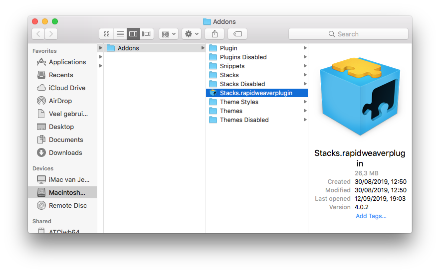

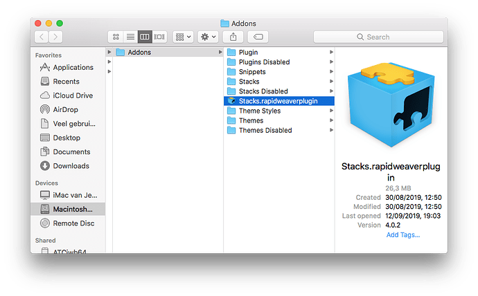

@Jerome – Just to satiate my curiosity since I’m not clear – What is it you double-clicked on specifically to fix the problem? Do you mean you double-clicked the Stacks icon to install Stacks into RapidWeaver?
from the screenshot you can tell that he definitely had Stacks 3 running inside of RapidWeaver 8. however it might have been an old copy of Stacks.
my guess is that somehow the upgrade played havoc on the addons folder and some older version was moved over that was not very compatible with the latest RapidWeaver 8.3. perhaps there is more than one copy of something installed?
i think it merits a fine-toothed comb look inside of the add-ons folder to see what’s what. i did a video on that if it helps: https://www.youtube.com/watch?v=FcalwrsJt7g
Hi @Elixir and @isaiah, yes I think the upgrade got mixed up, as I have not been tidying up recently. I now ‘let’ RW manage the folder. The pathway is somewhat long, but at least RW has sorted what and where it needs all the addons. I have deleted my old folder.
I had double clicked the old version of Stacks plugin but now have also the Stacks4
which did the trick to get everything back again.
