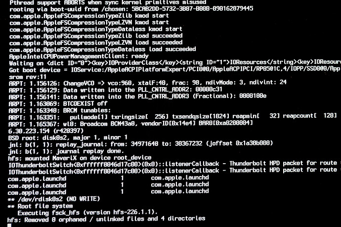

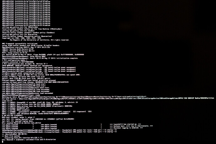

For about a year and a half or two years, I get this weird behaviour. If I use Rapid Weaver, and then shut down my computer, the next day my Mac can not start up. I get the grey screen with Apple logo and a spinning loading symbol. That’s it. I have to use the power-off button to get out of this predicament. Then, I start up with the R key depressed, wait for the Apple Utilities window to show, select “Reinstall from Internet” and wait about one hour for my OS to be reinstalled. After that, I am free again to start up my Mac.

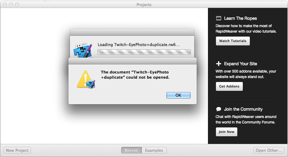

I have tested extensively for some kind of a meaningful pattern in this behaviour. The only constant is opening-and-saving my project within Rapid Weaver. If I just open my project and then close Rapid Weaver without saving, all is good. But if I open RW, then SAVE (even if I do not make any change whatsoever) and close RW, next time I try to start up my computer, it refuses to do so. There is, obviously, something that the OS is looking for at the startup and it can not find it, therefore, the loading never ends…
