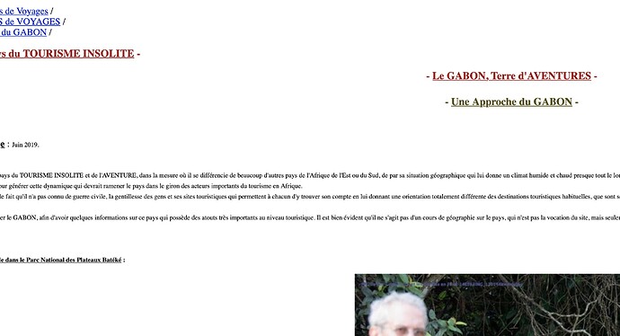

Hello,
When I worked with RW 7, all was good.
Now when I export new pages created with RW8, all the new pages are exported without theme. I have just written lines.
The old pages created with RW 7 seem good.
I spend days and days, but I never found a solution.
Is there someone to help me please ?
The first picture is what I have after exporting new page in RW8 (lines). The second is what I have with the old pages created with RW7.

Dear Sir,
Many thanks for your reply. You’re right, and I forgot a lot of informations. I really worked for more than one month and I can’t find a solution. I’m very disappointed.
I work with RW 8.2.1 on iMac with Mac OS Mojave.
My previous theme was DCGarageBand LX (it worked well on RW7 and on old pages with RW8). One week ago I bought a VENTURE 3 Theme on Michael David site. I changed the theme to see what could happen, but the results are the same.
The old pages coming from RW7 are good and the pages created on RW8 are the same (lines without theme).
I used RW since 2007 and I always found a solution, but today, I don’t know what to do.
If you can help me, I give to you many thanks for that.
Jean-Louis ALBERT / Franceville / Gabon.

J’ai l’impression que le fichier de style (consolidated-486.css) ne se charge pas. C’est pourquoi le thème n’est pas appliqué, mais à ce stade, je ne comprends pas pourquoi.

Hi Jean-Louis,
I have found that the css file is missing for your http://carnetsdevoyages.jeanlou.fr/Mini-Guide_du_TOURISME%20_INSOLITE_et_d_AVENTURE/ page. This is the reason why the theme is not applied on this page and an other one (contact page).
Perhaps the synchronization between your hard drive and your provider did not end well.
Try to resend your css files on your server to see if that is the solution.
Hope that helps !
Hello Anne,
Many thanks for your reply. I checked all the CSS files on my web site and you are right, some of them are lacking.
I don’t know why, but when I exported the site on my desktop, some css files were not exported.
So, I put manually the missing files on the server, and all seems good now. When I click on the page on Safari, the page comes with its theme.
I’m very happy and I give you many thanks for your help to solve my problem. I never thought to look on these css files. The problem is well solved and the topic could be close now. Thanks again for your help.
