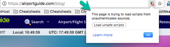

I think it is possible that you uploaded images that come from non-https sources and the browser is blocking it, because you have an https address.
I forgot to mention that I am logging into Admin and doing everything in https. The files are dragged onto the page from my computer so I’m not sure where that would play into it.
You have errors, Trying to load active content from a non-SSL source:
Check your console:
Doug beat me to it. Not sure if those insecure image links are from old posts (and not the ones in question) but those other errors could be the problem too.
