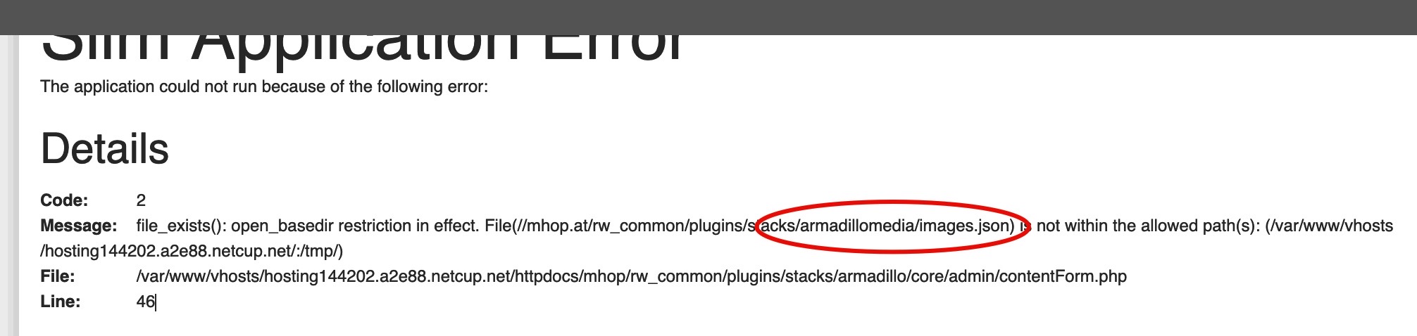

Hi everybody,
I am confronted with an error message on my websites with Armadillo: The 2 I checked had the same issue, so I am pretty sure the same error message will come up with my remaining websites with Armadillo.
I have no idea what the error message means. Can anybody help?
I have sent a brief note to Jonathan but couldn’t attach the screenshot below. @nimblehost
Based on the error message it looks like there is a PHP configuration setting on the server which needs to be adjusted, more specifically the open_basedir value needs to be adjusted to include the directory where Armadillo’s file are located. That, or the open_basedir setting itself should be removed from the php.ini file.

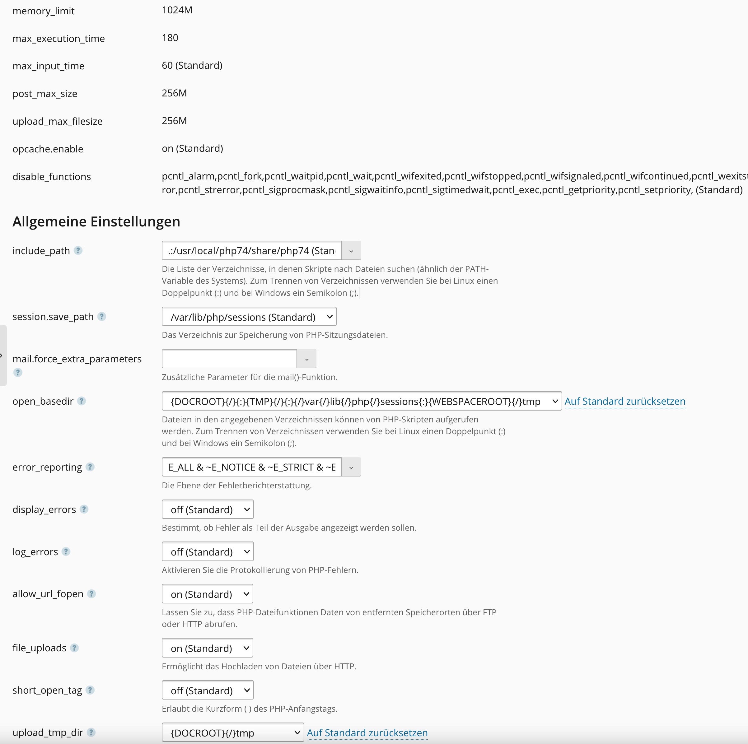

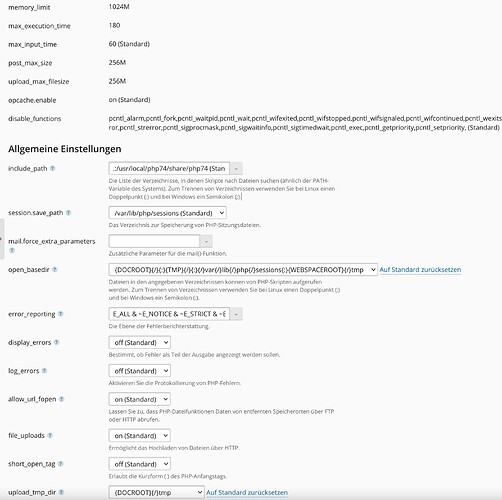

for your valuable comment. That led me to netcup’s control panel. I am not sure where I should try to make changes. These are the options:
My hunch is that a new path ought to be added in the open_basedir field. But how do I get the info which path is needed? Could the error message give a hint?

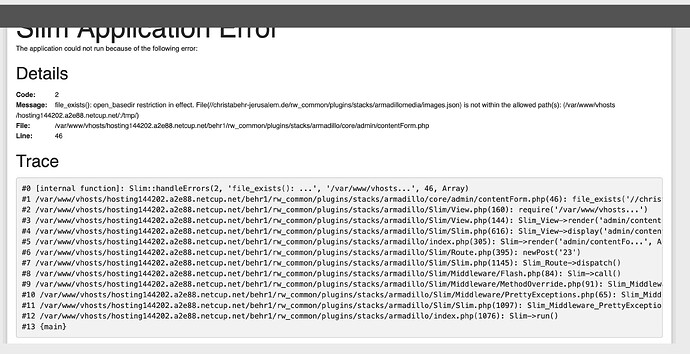

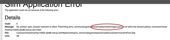

Slim Application Error
The application could not run because of the following error:
I am thoroghly puzzled how the changes could evolve, at 4 different websites at the same time, without me doing anything (at least I believe so since I haven’t made any changes in 2 or 3 of these sites for several months). Now all blogs are defunct, I can’t add a new entry nor make changes to the existing blog entries. Really strange to me…
This might be one to ask your hosting company for support.
Setting different php.ini file settings can vary depending on the host’s configuration. PLESK, CPANEL or a custom control panel all work differently.
Isn’t a common thing to change and can have multiple directories are listed so you might not find a GUI setting for it.
The open_basedir setting is primarily used to prevent PHP scripts for a particular user from accessing files in another user’s account. So usually, any files in your own account should be readable by your own scripts.
@Franz The comments from @RapidBase and @teefers are spot on - this is a server configuration setting and not something Armadillo can do for you unfortunately. As @teefers has mentioned the steps for making this adjustment vary from host to host, so contacting their hosting support would be my recommendation at this point.

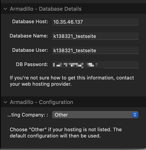

Meanwhile I tried to install a new Armadillo on a test webpage. Here I am defeated again. I tried multiple times and all I get is a blank page with the comment "Table ‘k138321_testseite.armadillo_post’ doesn’t exist“ From what I can see is that nothing has been written into the databank that I created.
Can you tell me how I can solve this installation issue? If I can get a new blog functioning I may have chance to compare it with those blogs that don’t function because of this open_basedir restriction problem.
The path “//[anlage4you.at/rw_common/plugins/stacks/armadillomedia/images.json]” is an absolute one, which means that it is not within your vhosts. Theoretically, it should be either “./[anlage4you.at/rw_common/plugins/stacks/armadillomedia/images.json]” or simply only “[anlage4you.at/rw_common/plugins/stacks/armadillomedia/images.json]”. Is there perhaps a configuration within your application?

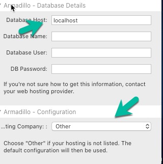

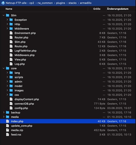

I’m doing a clean install on my main MacPro, so I’m on a backup machine. Might be helpful if you gave us a screenshot of what your Armadillo settings look like (Les the database password):
The Database host name can vary by hosting company. It can depend on if the host runs the MySQL database is considered being on the same server or a separate server. I’ve helped a few others with installing Armadillo on a few hosting companies and have always left that set to “localhost”. I understand that some hosting companies will give you a unique name.

When searching for a solution I felt I had found an error in the ERROR description of the SLIM application. There is a “/” missing in the name of the file that is said to not be in the right directy. I have circled it in red. The path should be … armadillo/media/images.json. - I don’t know whether this observation has any relevance. I have not fould a way to modify this path name anyway…
